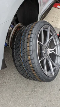

Front view very slight poke in the rear could have gone two or three millimeters more on back spacing

If it really bothers you, you can take them to be machined down.
We have the same spec rears, and I've been thinking about taking 5mm from the rears for a total offset of 50.
Most days I look at them and think they're fine, but then sometimes I'll think taking the 5mm off and they'd be spot-on perfect.
I'm thinking about that. not having any rubbing issues. I really researched before purchasing so a bit disappointed.
