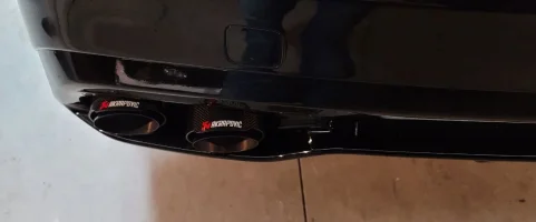

Went with the Akropovic style round tips. They required some grinding of the bumper to fit. They are attached to the Borla cat-back system. The grinding was not visible at all.
Overall, very happy!
What are the size of the tips you used inlet and outlet size , and where did you get them ?
Purchased them from a member on the forum 51mm X 89mm. Fit the Borla system perfectly.

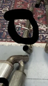

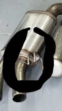

make sure these are parallel to the ground, should not have any issues with the exhaust tips into the tips.

He's talking about the clamps on the rear section of the exhaust. You can loosen them and adjust the pitch of the rear mufflers and tips so that they line up nicely in the diffuser openings.
