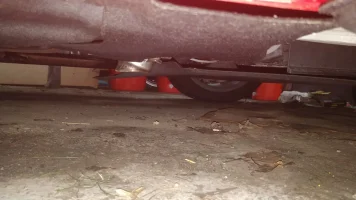

Updated:
The picture is right before they put the valves and tips on.

Just to be clear on the tips, are they "poking out" at all lower than the carriage?

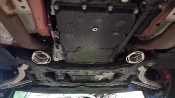

See attached picture - Could even cut them shorter, but mine aren't more than an inch at most.
The tips looked like this before they were cut almost at the turning point:

These are welded to the downpipes and are not a replacement bolt on. The cut pipes in the picture need to be welded. The tips however are bought separately and bolted on.

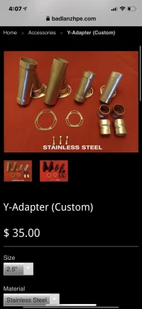

I guess I was thinking of something like these
