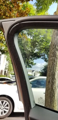

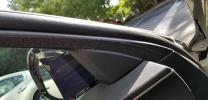

Thus far it appears that the fix that I applied to my drivers door has resolved my ticking issue. Some other people may benefit from this, so I'll post pictures. I noticed that the rubber seal that you can touch from inside the car while the door is closed doesn't get compressed snugly by the door. When I would poke it with my finger I was able to replicate what sounded like the squeak/ticking noise that I was constantly hearing when I would drive.
I compared the equivalent rubber seal in my fiance's '09 Infiniti FX35 and not only was the rubber compressed much more snugly by the door (which keeps it from wiggling and creaking), the plastic trim piece that the rubber seal rests against in the Infiniti had a texture that seems less conducive to causing rubber to squeak. All of these findings made me feel pretty confident that my issue could be solved by installing felt trim on the plastic part that rubs against the rubber seal.
Rain hasn't been an issue. The outside seal that contacts the actual painted door frame protects against rain. Even the rain that may fall on the felt trim when the door is open doesn't seem to cause any issues. The only thing I can think of that may be negatively impacted by the felt trim pieces would be an increase in outside noise in the cabin since technically I'm breaking one of the noise barriers. With that said, I don't notice a difference.
BTW, I kind of did this late at night so the curve can be improved. I will make it prettier sometime soon. Aside from the curved part near the top of the B pillar, it looks like it could be factory trim.

It's holding up great. Adhesion and durability hasn't been an issue and I park outside in the direct sunlight while I'm at work. It has gotten a little wet with rain but it didn't cause any issues. It has solved all of the ticking/squeaking that I experience with my driver side door. I haven't applied it to the rest of the doors but I plan on doing so this weekend. Below is a link to the product I used. It honestly doesn't look bad at all (looks like it could be factory if you install it well) and it'll match your suede headliner pretty well.

If you hear a small ticking by your ear as you drive, it can be due to a combination of one or all of the three sources:
1. The slight motion of the door frame's plastic trim hitting against the door's metal frame beneath it. This is because the trim is not tightly assembled on the door's frame and its plastic moving on metal makes the ticking.
2. Part of the sound is also from the motion against the rubber door seal - plastic moving on rubber.
3. The slight motion of the entire door over irregular roads thanks to the door latch not being as tight as it should. You can tell if your door is "loose" by lightly placing your fingers in between the plastic trim and rubber at the top portion of the frame. You will feel the door moving up/down if you have this issue.
This DIY is to address points 1 + 2, the plastic trim and rubber, to eliminate the majority of the ticking. The latch tightening should be addressed by the dealer, although at the time of this writing, I have not yet pursued this.
Here is the trim in question, shown for the passenger door. (All steps equally apply for the driver's door)
Fully roll down the window. Carefully insert a prying tool with light to moderate force to snap away the trim from the frame.
Pry along the entire trim, and lift up the bottom section to free it .
Apply felt tape along the inside, in particular over protrusions (contact points)
Apply felt tape along the metal door frame lip beneath the rubber
Snap the trim back on. It will feel tight.
Apply a silicone spray along the rubber seals found on the door frame and the car's frame (not shown).
DONE!
