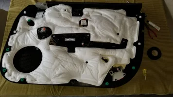

Sure. Here's a pic of the driver's door panel I took out when troubleshooting a creaking sound which I fixed (will post a separate diy)20181019_152358.webp You can see the green and white clips I'm referring to so you get an idea of their location.
This really makes me want to remove the panel and drive around without it, just to see if that's where the ticking is coming from.
Might be a good idea to troubleshoot. NOTE, I had two sources of noises.
1. Ticking around the door frame (i.e. per this thread/DIY)
2. Door panel creaking/squeaking (both front doors) - reproducible when there is some car flex like turning up or down a driveway. Also reproducible by just pressing hard against certain sections of the door panel. I'll create another DIY hopefully by this weekend.
