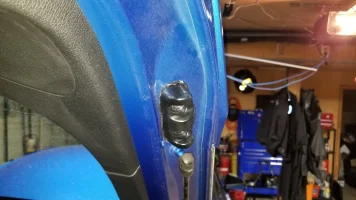

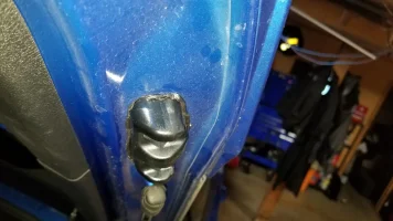

Thanks guys for the info. I actually bought some decently thick gt mat to put behind the license plate and used some leftovers behind the bumpers. Worked like a champ.
Could you provide some photos?
I did this fix last week (I just used two washer) and it's been working great. Actually drove the next day; was almost at work and noticed how quite it was lol
Interesting. I have my 7500 oil change soon and am gonna see if they finally have a fix for the recall. If not, I'll try this!
