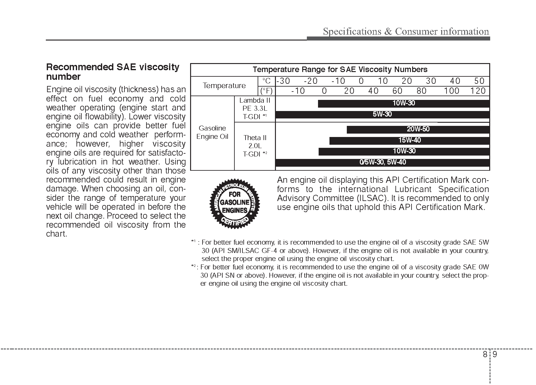

Once I get my next oil change , I will run it every 10 k with 100% synthetic 0 w 30 , race oil which i already have in my engine he he
It's your call, but KIA's stated requirement is 5W-30 for this engine, even though 0W-30 would give them both better fuel economy numbers and cold start lubrication - obviously they felt there was a need to go with the heavier weight oil.
Your Stinger should have 10W-30 in summer, and 5W-30 in the winter.
Synthetic blend would be a good choice too, because many conventional oils get thicker as they get old at their cold temperature. Synthetics are better able to maintain their weight at cold throughout their useful mileage.
Curious if the Canadian manual has the same table?
Yes, exactly the same charts for both the 2L and 3.3L engines, with the 3.3L showing a minimum viscosity of 5W-30.
I use 5W-30 full synthetic in the Stinger year round, which also meets the OEM requirements for my other vehicles.
NO
This is the 2019 Stinger Manual
NO
Guess they changed it for 2019 - the oil chart in my 2018 Canadian manual is exactly the same as the one posted by @nhcowboy28.
Regardless, 5W-30 is still the minimum viscosity for the 3.3L. The only engine I've ever used a 20W-50 oil in was an air cooled 113 cubic inch V-twin. :p
