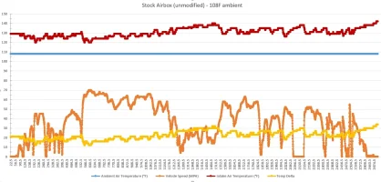

I have an IAT log from the stock airbox from a hot summer day (108F) in Tucson. Car was parked in direct sunlight for ~8hrs at these temps. For the Stock airbox, the average delta between Average IAT vs Ambient temp was 22.5 degrees.
Highest IAT recorded on the stock airbox was 142F (against a 108F ambient)
The graph plots time (in seconds) across the bottom, vs speed, IAT, Ambient Temp, and the IAT-Ambient Delta. Total commute is about 45 minutes for the plot.

That data is extremely alarming - almost indicative that any form of heat shielding from the engine is a must for cooler IAT results.
Keep in mind it’s hot here in Tucson during the summer. I plan to make more plots as it cools down to more normal temps.
Also, I should have mentioned that those numbers also came from my car after it was baking all day in the sun at those temps. It was my drive home from work.
