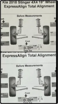

Jumping in here as well to see if anyone has my issue. Have a very similar setup to you. Eibach springs & sway bars as well as Megan racing rear camber arms. Just had my car aligned this morning for the 3rd time in 3 weeks. Car just kept losing alignment and would pull slightly to the left. Tire pressures are fine, and I haven't hit any potholes or anything. Each time I brought it in they said the front toe was way out. Anyone know why this would be happening? Seems like the rear of the car is fine its just the front toe that keeps losing its spec. Shop said to drive it for a week and bring it back next week so they can look at it. Any help would be appreciated as always!
Here are the last 2 alignments I've had.Alignment 10-10-22.webpAlignment 10-4-22.webp
In both of those printouts, the "before" measurements for front total toe are "in spec"
Odd.
Very odd. Perhaps they meant rear toe when they said front toe was out? Still not sure why it would lose alignment without hitting potholes or anything. Hoping that this 3rd time will stick
