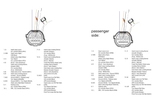

I was able to do this (almost, just need a better set of voltage regulators. The harness is the same but you need to attach a resistor in parallel for the turn signals and a voltage regulator for the low beams. Then bulb out warning is gone and the lights work. I got a great deal from someone who sold the pair. Anybody have a driver side lens they want to sell?
The ground to use for the turn signals is pin 7 btw

i'll post the details here in case anyone in the future needs it
but basically you'll need the voltage regulators (anti-flicker for blinker) and the power converters (canbus for power stepdown) like you said
as well as the led headlight set
for wiring you'll need to get the canbus in line with the power wire, you can either cut the wire OR as i've learned there's a harness out there, you can do all the mods to the harness so you don't mess with the OEM wires in case you ever undo it like when you go to sell it
ports 1 and 5 are for the headlight itself that requires the stepdown converter, i used this one (you'll need 1 for each side)
for the blinker you'll want 50w 6Ohm load resistors, the ones i got aren't on amazon anymore but here's similar ones
these you can just tap into with either t-taps for the snap connectors that come with them (ports 3 & 7)
check my saved IG highlights for visuals of how the wiring looks like inside, it's a mess since i didn't use a harness, also i have old power converters in this clip, i upgraded to the ones linked above since it was flickering randomly
lemme know if any questions or troubles!
the headlights themselves require taking off the bumper, unbolt the original headlight (3 bolts) then slide it out
