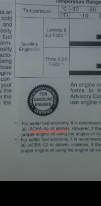

No, it doesn't. It only gives you the range.Kia's recommendations and methodologies are ambigious, vague and borderline nonsense.
Example,
For the 2018/2019 Stinger, Kia states on the owners manual to use an "5w30 ACEA A5 or higher" oil.
Define what is suggested by above ACEA A5? Pure ambiguity.No, it doesn't. It only gives you the range.

i like how it says "for better fuel economy " how about for better engine life ...Define what is suggested by above ACEA A5? Pure ambiguity.
Now i am wondering, will it be better to use 15w40 or even 20w50 for summer time only?i like how it says "for better fuel economy " how about for better engine life ...
