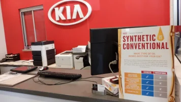

Kia service uses full synthetic now, since January. I don't even ask what "brand", because whatever it is goes with the warranty.
Was there a time when full synthetic wasn’t recommend for Stinger engines?
Even the owners manual doesn't say anything about "recommended" full synthetic. This was when I first noticed the change, 30 March this year.
