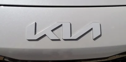

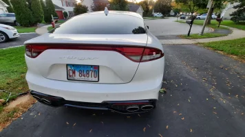

I did it this week use the stencil that comes with it to line it up. I used sticky takt to hold it on without damaging the paint, it came out well. I covered the holes perfectly. I filled the holes with a resin before adding the new badge..

I wanna replace the rear stinger badge with the black stinger badge.. is it hard pulling that off without any nicks to the paint. The front E badge went fine cept for 1 little ding
Yes, I did the rear as well and I did scatch the paint. I think I would use a heat gun if I had to do it again. Plus put goog be gone under the badge helps not scratch the paint. Get the plastic emblem tools off Amazon. If you take your time you shouldn't hurt your paint.

I feel the same, I wanna replace the big chrome Stinger script on the back with "black chrome" or something that's more of a match to the stock trim, mirror caps, front end.
Using a heat gun increases your chance of a cock up exponentially. Whenever you read about someone bubbling their paint guess what the cement handed dim wit used a heat gun. Hair dryer, fish line, goo-gone, patience, buff out tiny scratches, carefully stick on new badge. Looks great job well done. Simple!!
Thanks, I didn't use a heat gun but heard of success. This is why its great to be apart of this group to get multiple peoples experiences..

Where did you get the white decal?
Thanks.
I bought it here, but you'll have to request it to made in the color you want as their drop down options are just matte or gloss black. Hoping someone else starts making them for $10 or less...
Thanks.
Hell, you plastidip-ed the 'Stinger' badge on the back... that was less than $10! Painting the front 'KIA' badge would be even easier...
Well, I bought the front KIA decal before I thought about plastidipping it. Derp on me. :P
