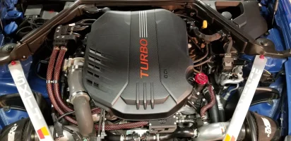

I can only speak for the SXTH Element Dual Catch Cans. I choose the dual for my Stinger as I am someone that cleans the engine bay every time I wash my babe (just about every weekend) and I love to show it off any chance I get. The SXTH Element Dual cans are well made, damn good looking, and the "GT" bracket added a very nice touch. I did shave down the right side of the GT bracket due to my K&N intakes.
Performance, the PCV side has been very effective, while the other has not caught anything really (as expected).
I did add some Braided Sleeving to the hoses to dress it up a bit more.

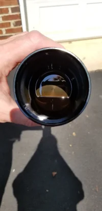

On my first emtying (PCV side) after about 1 month of daily commuting:

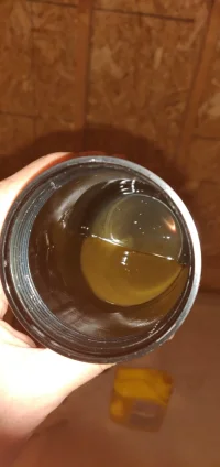

SXTHElement as well. This is what I got after only 1400 miles.
If you are catching this much oil every 1000 miles or so, should you be checking the oil dip stick and topping it off each time you empty the can?
That’s not much oil and certainly not enough to alter the oil level. Also mixed in there is also water vapor, fuel, and condensation, which gives it that chocolate milk type look. I’m not sure how often you have the oil changed, but that’s pretty much the normal time to empty the can.
