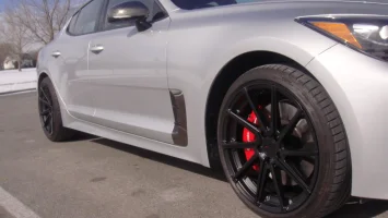

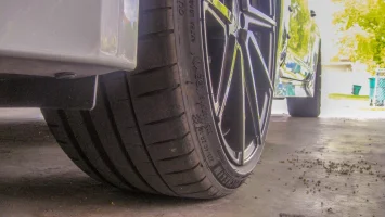

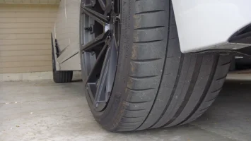

Here's the link to what I did. Per my experience 19x9.5 +30 will work no problem with those tires.
I went with 19x9.5 +35 and needed 5mm spacers up front. +30 would have been perfect.
Note the wheel and the 255 tire are about flush with one another at 9.5"
At 8.5" you'd have a little more protection from scraping curbs if that was a concern.
Can't be sure on the 8.5 +40
Looks like you used spacers at the front with your 19x9.5 so maybe I will stay at 19x8.5 and squared the set up.
I ll need some hub ring like your set up too but had those on precious car and once on , its on :)
I needed the 5mm front spacers with 19x9.5 +35 which effectively made my rims 19x9.5 +30 So I think what you are looking at would work.

Unless you put up with some poke, I don't think that 9.5" wide on the front will clear the Brembos.
Awesome , thanks, I wasn’t sure.
Therefore with this rim the ideal set is 19x8.5 30 offset ( which mean I will even be able to reuse the stock tires too)
My 19x8.5 are 40 offset. Stock tires. So, stretched half an inch more than OE wheels.
Very clean set up!
Very clean set up!
Thanks. I relied on "my wheel guys" at Wheel Werks to select and set up my aftermarket wheels properly. Here's what they look like in the wells: No poke:
