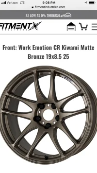

Hey All, I’m looking for some validation before I purchase.
Noob question first; my wheels/tires are ‘Staggered Stock 19’ because my tires are 225/40ZR19 front and 255/35ZR19 rear (2019 GT RWD) but could someone clarify why when I measure the face of the wheel with a tape measure it’s 20.5” inches? You see I am ignorant and I have always purchased wheels off of craigslist or off an owner of the same vehicle.
Onward...

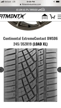

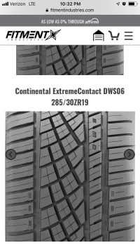

I did my best using the wheel size calculators and referencing the table (great info awesome work thank you to everyone who’s contributed) but there isn’t a 19x10.5 row or backspacing, unless I missed something. I want to run 19x10.5 on the rear and maintain as close to stock overall diameter. I ended up with 285/35ZR19.
I’ve attached photos from my shopping cart and there’s info below on the combination I’m about to purchase in the next few weeks. This is my first time ordering wheels/tires to a specific size.
I know the offset of these wheels will stick out a little but I’m not a math wizard (about 3/16” of in inch in the front and 5/16” of an inch in the rear). This is somewhat intentional for a more aggressive stance.
So does the following setup match stock diameter/will these fit?
Front: 19x8.5 (+25) - 245/35ZR19
Rear: 19x10.5 (+32) - 285/30ZR19

I can’t decide to go with the 285/30 or 285/35 in the rear. The difference is 0.3” inch smaller in diameter or 1” inch larger in diameter. Stock suspension.
You should be ok but I would go with 35 since they are 19. I have 255/35/20 and 285/30/20.
