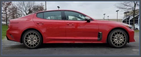

19x9 +32 flush fit not touchy the brakes
Wow that really shows you it all comes down to the wheels! Mine are 9+35 and plenty of clearance. I do think 9+32 is closer to the ideal fitment for our cars in general.

Here’s my 9+35, you will need at least 9.5+30 if not 9.5+25 and you’re going to be poking, which you might be ok with

I don’t have pics off hand, but there should be no poke with that fitment and it should look flush. My 9+35 are just a little inset in the front and would be more so in the rear.
Thank You! That's exactly what I wanted to hear. I can always toss a thin spacer on the rear to finish it off if needed.
