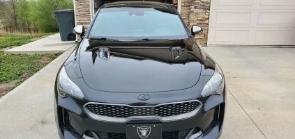

Because I bought my Stinger used last fall and the weather finally turned nice I really started looking into giving it a wax job. As I looked at the paint you could see swirl marks from lots of automatic car washes. Made the decision to go all in and clay bar, polish, seal, and glaze the finish. After dropping almost $200 US chemicals, polishing pads, rags, etc. I spent a Sunday and got to work with the help of my Son in law.
What a huge difference. I've owned my Stinger for 6 months and just now realized that the Aurora Black paint job is actually a metallic black. After clay barring the car there was this haze to it (which is normal).
We started the polish stage doing one panel at a time. I was shocked as we removed the dried polish and the paint started to pop and sparkle in the sun light. I had no idea this car was this beautiful. I mean it looked good when I bought it. Now it looks phenomenal.
Once the polish was done we began applying the sealant. After seeing the way the car looked I did not want to lose that ear to ear grin I got from seeing those metallic flakes for the first time.
After the sealant was applied, dried, and buffed we moved on to the final phase the glaze. I chose Chemical Guys Wet Mirror finish based on reviews and videos I saw on the internet as being one of the best glazes for black paint.
So 6 hours of work using Chemical Guys Clay bar, Chemical Guys V36 Polish, Chemical Guys Jet Seal, and Chemical Guys Wet Mirror finish (seeing a trend here?) and the result -
