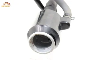

I have this too, I tried to scrub it off also but it won't come off easily. Isn't this metal aluminum which technically won't rust? Isn't this just surface rust on aluminum? I sprayed some WD-40 on there as preventive measure and cleaned it up abit but I could not remove it all.

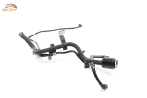

Check out the pics I found of the FILLER NECK Kia part on the internet and the plastic housing that covers the very tip of the filling neck. I don't know if it's aluminum or not...
I scrubbed it off as much as I could, cleaned it up and sprayed some gray automotive paint on that tip of the neck that looks like aluminum but might not be.
I always assumed the filler neck is aluminum too. nothing on mine have attracted my notice yet. but I haven't filled up since I saw this thread, so, we will see.
Try sticking a magnet to it. If it sticks, it's steel. If it doesn't, it's either Aluminum or high quality stainless steel. Low quality stainless is also slightly ferrous.
Edit: Figured I'd give it a try. Sure enough, magnet sticks. Guessing it's steel.
