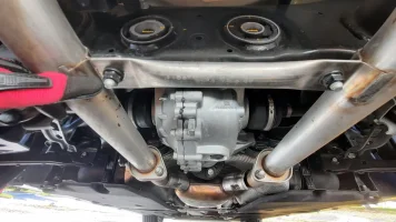

Not today, but 2 years ago my MBRP went on with @BertBert2019GT help. Still have it, still loving the sound and zero issues in those 2 years. :)
mbrp_2_years.png75250874_2706317076055427_2532485826378465280_n.jpg73216148_2706317319388736_1989616361189408768_n.jpg74701522_2706317066055428_2496267110200639488_n.jpg74421003_2706317039388764_7947235385178849280_n.jpg76647906_2706317249388743_5427728516177199104_n.jpg

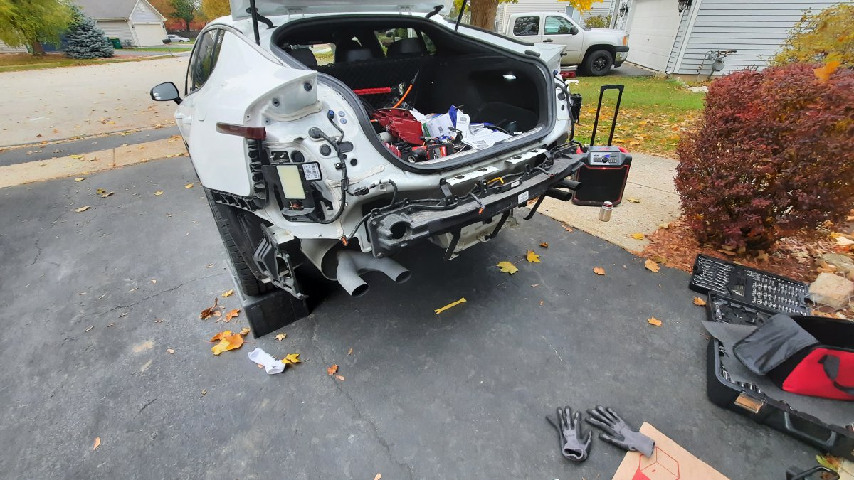

I just finished this on my 2022 GT-Line today, also. Didn't see your post until now. I also took a few shortcuts with the parking sensors, and I trimmed the heatshields with them still on the car. Also, I slid off the exhaust hangers instead of unbolting them. I also didn't bother to put those 2 hellish metal teeth clips back on. The bumper is totally secure without them. I've read other installs where folks left them off as well.
Good idea about trimming off the edge that's so close to the exhaust. I put 2 layers of Gorilla tape there to provide a cushion in case that tailpipe sways and hits it during cornering transitions. If that doesn't work or it burns off, I'll get out the grinder like you did.

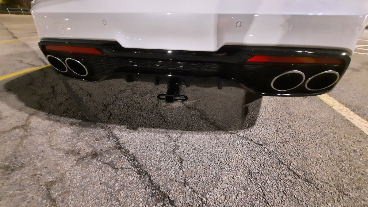

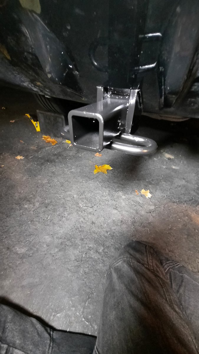

I got it to work but also had to enlarge those same 4 bolt holes on the main body of the hitch. Looking back on it, I think the issue could be avoided by modifying the video and printed instructions somewhat. Currently, the video says to first torque down the support brackets. The print instructions and video instructions would be better to say leave the support brackets loose, and torque down later *after* installing the main hitch. This would have allowed more space for the other bolts to fit without having to enlarge the bolt holes. The space isn't there if one tightens down the support brackets first.
20211109_134349-jpg.104889
20211109_201020-jpg.104890
20211109_212858-jpg.104891
I had some banging of the exhaust on the hitch over big bumps. So I used an angle grinder to take down the corners a bit, and also spread the tailpipes further apart for more clearance by adjusting this bracket. All good now!20211121_135937.webp20211121_134845.webp
