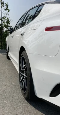

Also put on the rockblok splash/mud guards.IMG_9684.webp

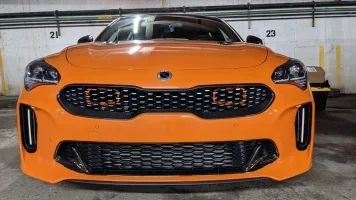

Installed the VelossaTech intakes. Pretty easy, and I didn't even have to cut out any holes in the grill. I guess the GTS has the GT2 grill pattern but without the center sensor cluster?

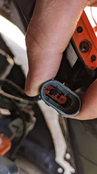

Unfortunately while putting the bumper back on I carelessly destroyed the connection to once of my CK71 DRLs by plugging it in wrong :rolleyes:....hopefully they can send me a replacement. I had to unplug the other one until its fixed because I refuse to become another 'H-K with blown out lights' lol.

The VTs look like they may be positioned a little more inboard though
