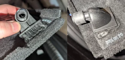

It's my turn now! See attached image. Don't know how it happened. I think wear and tear. Showed it to the dealer and asked if they could glue it (I'm under warranty but this is probably wear and tear) and they said I'd have to get a new cargo cover. I said I would glue it then. As this thread is a few years old, I'd like to hear from
@Snicklefritz, @JSolo, @D.J., @MerlintheMad, & @Devin if the fixes they made still worked or would they do something different. I have JB Weld Plastic Weld (World's Strongest), Gorilla Fabric Glue, Gorilla Super Glue (Impact Tough Formula), Loctite Super Glue (Gel Control), and Loctite Plastic Bonder (Glue and Activator tubes). But I'm willing to add to the collection.

Literally least wek, I too re-bonded mine.
I used marine Goop instead of epoxy - cause it's what I had on hand.
I was very surprised it seems so cheaply made right from Kia. It appears to be factory bonded - to the carpet.
Can confirm, mine is still holding strong today...

Mine was very much like yours, so I cut it off completely, cleaned it up, and glued it back on, clamped it with some weight that I had kicking around, and that's it.
My two-part epoxy - Gorilla brand, but any will do - is holding strong. I cut the hinge away completely too and generously applied the epoxy to one surface and pushed the hinge down firmly while it set, which as you probably know takes c. five minutes is all.
