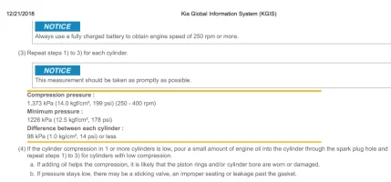

Compression on all cylinders is at 150 and kgis says 178 is normal they already replaced an engine for compression and now say that the tech and techline think that the info in kgis is wrong......
LOL - that's kind of hilarious.
178 psi seems very high for a low compression 10:1 engine
Sure enough.... 178 is the minimum (wow)
199 is the design spec - and 178 is the minimum allowed with less than 14psi difference between cylinders.
No it was the transmission temp reading from a logger that I had in the obd2 port. Engine Oil temp was at 200. It will actually get going in 5th gear doesn't like it but it had enough power. This actually happened again yesterday same gear but it corrected itself like all other posters in this thread. I have actually had nothing but problems with this car I'm on my third engine and it is in need of another. Compression on all cylinders is at 150 and kgis says 178 is normal they already replaced an engine for compression and now say that the tech and techline think that the info in kgis is wrong......
Wouldn't it be funny if they were testing the compression on "most" cylinders without taking off the intake manifold - and they were testing with the throttle plate closed for some reason - giving a false low reading
