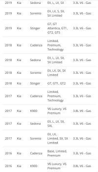

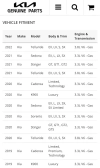

I’ve noticed there’s a lot of aftermarket for the other Lamba equipped cars like the old Genesis coupes and it got me wondering if our engine share any parts.
So far the water pump pulley cross references with a lot of, if not all Lambdas including the NA 3.3 and 3.8 engines.
So my logic would suggest this and possibly many other Genesis Coupe parts might fit our cars…
