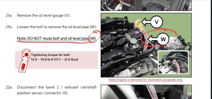

I've heard problems of the dipstick end cracking, maybe that's why it's replaced, not sure why the oil dipstick tube would get replaced unless you can't remove it without affecting the seal perhaps? The more I think about this the more prone I am to wait until it HAS to be repaired. One good think is recalls aren't affected by warranty time/miles, so no real need to hurry up and get it done.
Are they replacing the dipstick, or the dipstick guide tube only?
I'm pretty sure that "W" refers to the guide tube, and not the dipstick itself, which is "V"

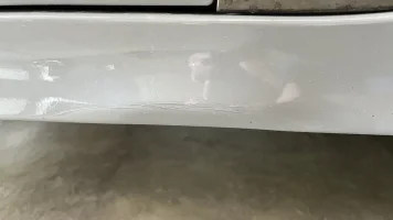

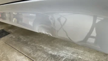

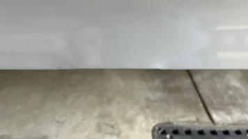

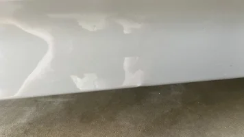

My local dealer did the same thing to my side skirts last summer when they had it for warranty work. They replaced everything with new OEM parts, but still a hassle and makes me nervous anytime they're around my car.
If I have to take my Stinger to the dealer, I take a video doing a full walk around my car in their parking right before I hand them the keys.
Asking for the replaced parts seems like a good idea.
The parts listed in my post above are what's included in the recall kit, and the "oil level gauge" is part of that kit, so I guess we're getting new dipsticks too! Hopefully that's the only dipstick we're dealing with, and not the tech assigned to our recall work.
I believe that is a typo on the parts list.
They wrote "Oil Level Gauge"
But I think they meant to write "Oil Level Gauge Pipe" referring to step 21b item W.
If it's not a typo, then the parts list is missing the "Oil Level Pipe" which is not to be reused per step 21b
Yeah, that's probably the case, and I like my current dipstick :)
