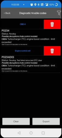

2022+ are known to wind up going into overboost condition, especially in cold weather. When it happens it doesn't trigger a check engine light. The only way to know is to hook up a proper code reader to the OBDII port. When it happens to me it comes up as a "Pending code". My guess is if it happens during multiple drive cycles it eventually trips a code. Problem is it doesn't seem to happen often enough to trip a code. It's happened to me about 2 or 3 times so far since winter set in. For me, it usually seems to happen when the car is producing full boost and changing from either 2nd to 3rd, or 3rd to 4th.

This is an old Car Scanner Pro screenshot from when I overboosted a while ago. The overboost code is P0234, the ECU logs the code but it won't throw a CEL.

Can now confirm if you allow it to overboost on two drive cycles in a row the CEL does come on. Tried to purposely do it today. Sure enough during the second drive the CEL comes on. Both times the overboost occurred shifting from 2nd to 3rd. Interestingly enough, when the CEL comes on, even if you cycle the power after, if you put the car in sport, it'll drive like you're in comfort. Don't want to bother with it right now so I cleared the code. Got too much to do this week to add bringing my car to the dealership and having to deal with them.
