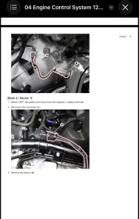

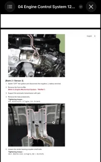

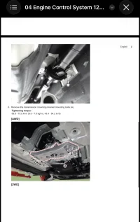

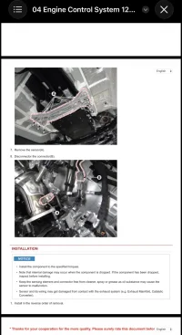

I’m trying to change bank 2 sensor 2. Driver side downstream. It’s a pita and still haven’t been able to do it.

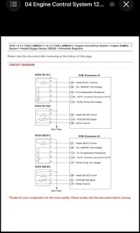

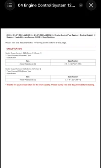

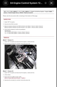

Photos from shop manual if anyone needs or wants them.

I bet I know why: the passenger/right side bank is further forward, and where cylinder 1 is. Driver/left bank is behind it with the even cylinders.
Yup, precisely. IIRC, every manufacturer - at least modern - numbers the most forward cylinder as #1. Right side bank of a V being forward of the left bank is very uncommon.
