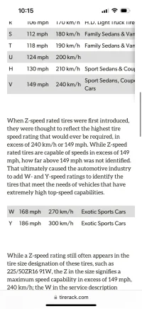

It isn't the a/s versus summer tires that determine the speed limiter setting per se. if the wheels are 18" they are on an awd model with a/s tires, and get the lowered top speed. awd with 19s get summer or higher speed rated a/s tires like the michelin, which I believe also come on the stinger as ps a/s4. do you happen to know if the speed ratings differ between the primacy tour and ps a/s4? in any case, they are over 167 mpg rated, at least 'w' or 'zr', which is why kia didn't put a lower speed limiter on your car.

R106 mph170 km/hH.D. Light Truck Tires
They are but I looked up the ratings, while they’re R rated the 96w actually means they’re rated up to 168, kinda confusing but makes sense now.
