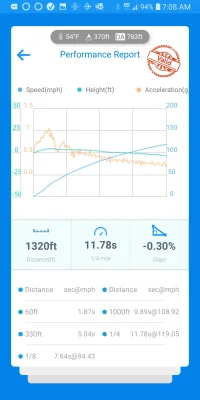

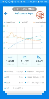

That is very fast!View attachment 24213
Have peek at that trap boys and girls
Thank you very much!
Thats some slope for a drag strip. I bet you got a few invalid runs. Too bad the elevation isn't lower it would be a super fast track.

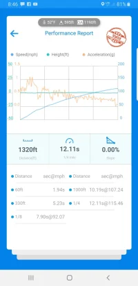

Did dragy also show 121 on your fast trap run?it's not, dragy results varied View attachment 24337 from dead flat to -99. Heres another. They cant seem to get slope right.
