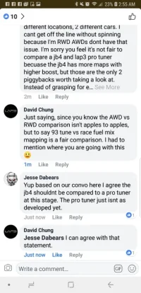

So i dont just post a partial of what was said:
  • David Chung The difference would be, LAP3 is still running 93 mapping w/ 5psi over stock, while JB4 is running E30/race fuel mapping +7psi over stock. 93 map vs 93 map would have been a fair comparison, Jesse Dabears. Hence mods to mods comparison isn't really relevant for this race.
    Once we have the app updated, we are planning on adding more mapping for those running higher than 93 octane.
  • Jesse Dabears
    They both ran higher octane one ran 93+ boostane (jb4) the other ran 93+ e85 (lap3). One used the 2nd highest map available to him (he could have ran map 7 which is higher boost) and the other ran the highest map he could run without meth. I think is a valid comparison between the two piggybacks David Chung

  • David Chung
    Jesse Dabears One can use higher octane for any map they are running. Scott could run 93 octane alone for the mapping he's currently running. Added e85 isn't going to change the fact that Scott is running 93 octane map. If you wanted to make a valid co…See More
  • David Chung
    Though it does bring to our attention to let others know that we will be releasing more mappings down the road for more power for those who want to run higher than 93 octane without meth.
  • Jesse Dabears
    They both ran with what they have available to them with their piggyback as they currently stand. Good to hear in the future the lap 3 will have more mapings like the jb4. It might be more even then. As of right now the jb4 clearly has the lead at more than half the cost.
  • David Chung
    Jesse Dabears As far as the selection for mapping, yes JB4 does have more. 91 vs 91 on the other hand Robb Banagahas run against a JB4 with same GT RWD, same mods, edging out JB4 so slightly. That is a fair comparison as both were running same 91 fuel & 91 mapping.
  • Jesse Dabears
    Again the comparison is what available to them now. You keep wanting someone to downgrade what map they are using to slow them down so it's fair for the lap3. The comparison again is the piggybacks one with high flow cats (lap3) the other with still th…See More
  • David Chung
    Jesse Dabears Were you at the track as well? Have you had a chance to run your car?
  • Jesse Dabears
    Yup I did. But this ain't about me? If you would like it to be or about that day check the leaderboard I'm ahead of every other RWD lap3 prontuner. Also check #2 on the list it's a jb4 running 11.97 awd I ran 12.1s rwd
  • David Chung
    Well, you brought it up as JB4 vs. LAP3. So figured to chime in as to we are comparing two different octane mappings. The required octane for those two vehicles' mappings are completely different. I figured to ask since you are running JB4 after all. A…See More
  • Jesse Dabears
    Running what times? 12.1 we are now talking different locations, different tracks different mods lol. What I posted was a direct comparison. Same track similar mods (lap 3 is actually running high flow cats and jb4 has primary cat still intact). I'm sorry you feel it's not fair because the jb4 has more maps.... maybe when the lap3 when its more developed will hold it's own.
  • Jesse Dabears
    He is also AWD I am RWD so again not sure why you keep throwing different comparisons together now. David Chung
  • David Chung
    Jesse Dabears I would have no knowledge of your vehicle spec, but good to know. You can't assume that I know your car to be AWD or RWD, but hey that information helps. RWD has less drivetrain loss w/ ~200lb less weight, and will always accel as long as 60ft is similar. You are right on that though. These cars are harder to compare as base GT RWD w/o a sunroof and GT2 AWD have about 300-400lb weight difference.
  • Jesse Dabears
    Lol why are you grasping for anything now. My car and that car ran at two different locations, 2 different cars. I cant get off the line without spinning because I'm RWD AWDs dont have that issue. I'm sorry you feel it's not fair to compare a jb4 and l…See More
  • David Chung
    Just saying, since you know the AWD vs RWD comparison isn't apples to apples, but to say 93 tune vs race fuel mix mapping is a fair comparison. I had to mention where you are going with this :)
  • Jesse Dabears
    Yup based on our convo here I agree the jb4 shouldnt be compared to a pro tuner at this stage. The pro tuner just isnt as developed yet.
    1
  • David Chung
    Jesse Dabears I can agree with that statement.
