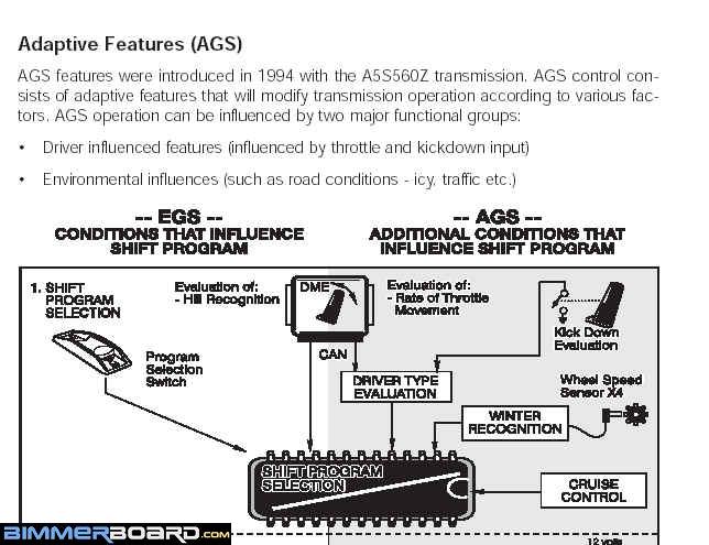

Sounds like something worthy of further investigation. To be more specific, the service person said they reset the transmission. I made the assumption he was referring to the TCU, but now realize I may have jumped the gun on that assumption. On the invoice, the tech just wrote that he "reset the adaptives." My gut tells me the car does self adjust based on driving style in one form or another, but I'm no car guy.
Maybe he reset something like this that I found for a BMW?

I don’t think so since he said I did not need that TSB. I’ll do more digging. Mostly curious what adaptives are and how they work.

I'm not so sure that the TCU does NOT memorize a driving style. It sounds like shift points can be based on calibration curves in memory. So unless I'm mistaken, there's an algorithm that uses inputs from various sensors to determine the shift points. On a basic level the car remembers whether the driver drives aggressively or relaxed and makes adjustments accordingly. This article talks about "ongoing memory:"
