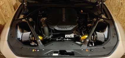

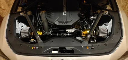

Very little space. You just need to bend the bracket a little more out to a 120-140 degrees instead of closer to a 90 degree
Can the bracket be moved to another location ... Or simply be removed?
Rango, the vinyl carbon wrap on the engine looks nice, what brand model, etc did you use?
What vinyl wrap are you refering to?Rango, the vinyl carbon wrap on the engine looks nice, what brand model, etc did you use?
You can remove the bracket if you want, but the hose that attaches to the driver's side intake elbow will hang down quite a bit, and it could possibly get caught up in the front drive belts. You'd have to figure out some way to keep it from doing that.
Also, keep in mind that the bracket will get in the way of the driver's side diverter valve hose if you have an AEM or K&N intake. I trimmed mine down so it would stop digging into the hose...
Before....
After.....
Obviously I have a G70 and not a Stinger, but the problem would still be the same between the two.
Assuming this is a wrap...What vinyl wrap are you refering to?
