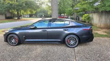

Supra Wheels on Stinger??
The H&R RWD specific springs
Ohh okay cool! Those are the springs im currently running. I might have to steal your idea if you dont mind lol

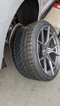

No problem I was just trying to find a cheaper solution to put forged, lighter, and wider wheels on this car.
Just machine the CB to 67.1, here it costs $75 a wheel (retail) to do.

Supra! Those are sharp wheels. And you taught me a few things about fitment finessing I didn't know.
There is a set of 3.0 Premium Supra OEM wheels for sale here locally for $850, which is cheap for forged wheels. 19's aren't my thing, and even if they are the 18's, once modified, it's a bit too specialized an application IMO. OEM GR Supra Premium 3.0 wheels $850
I ended up doing 255/35 up front.. the 245s were a little too much stretch compared to how the rears with 285/30 looked
