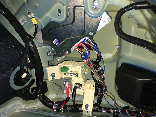

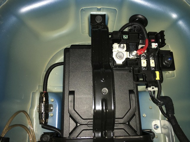

New member here- I want to thank all the contributors especially WildBill for your incredibly informative posts. I completed my subwoofer install in my 2021 Stinger GT2 last night and it was REALLY straightforward thanks to you guys. I'm posting an overview here of what I did and used in case it helps someone else in the future.
Installation process:
1. In trunk passenger side take off felt panel to expose fuses. If you peek through the hole you can see the connectors that are detailed in the pinouts provided elsewhere in this thread. you don't need to remove the panel to access the harness.
2. find the red connector (which is the B connector in the diagram and has a sticker saying 1 on it), pull the tab in gently and remove.
3. Identify these wires (thanks Wildbill) to tap off the speaker level output from the sub channels. (I chose not to tap the front or rear speakers per the earlier discussions of filters being present in the signal output).
SUB 1 + White
SUB 1 - Brown
SUB 2 + Red
SUB 2 - Blue
4. Tap into these wires. I used the blue connectors in this kit that I bought on Amazon for $12 "AIRIC 120PCS T-Tap connectors wire splice kit"
5. I highly recommend a good splicing tool to make the connections. I tried a pliers and it didn't work- I had to make a trip to Home Depot to get a good one.
6. This is the subwoofer I highly recommend for this installation: Rockford Fosgate P300-12 Punch it's $269. They make a 10 and 12" version. It's powered by a Class D amp, takes speaker level inputs, has a level control, is inexpensive and sounds really great. I had it in my prior vehicle and love it.
7. I used the provided connectors to splice to two sets of 2 conductor speaker wire I had then connector to the adapter provided with the subwoofer.

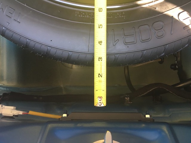

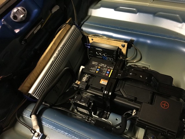

8. Remove the spare tire to access the battery. Use a wiring kit such as this "Boss Audio Systems KIT2 8 gauge amplifier installation wiring kit" that I bought on amazon for less than $20. I connected the positive lead to the small bolt on the positive terminal of the battery to the inline fuse. I attached the ground (I had to splice extra wire to it to make it long enough so maybe look for a kit with a longer ground wire or just use the extra positive wire like I did) to the same bolt that the battery is grounded to on the frame.
9. Run these cables to the adapter on the subwoofer. This particular subwoofer doesn't require a remote wire- It can turn on with an audio signal or DC offset (I used the former)

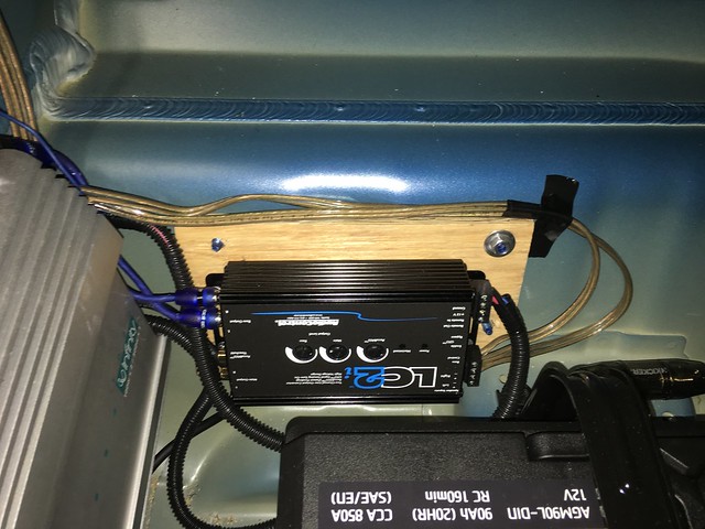

10. I placed the line level control with adhesive velcro on the side of the center console. For this subwoofer the input is set to high level, my crossover is at ~80 or 90 hz, phase is 180 and level you can decide yourself.

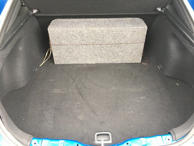

11. I attached the sub with a bungee cord to the child seat hooks on the back of the seat. the 12" sub didn't fit standing up under the felt trunk theft deterrent thing. It's laying on it's back facing up. I had the wires comes up from under the panel in the farthest left corner of the trunk.
12. plug everything in. power it up and enjoy.
This subwoofer added so much to the system. I'm an audiophile and it just didn't sound right without the tight thump that this subwoofer supplies. I ran the free iphone app "Sonic" to do sine wave sweeps to see how it sounded. I didn't touch the stock equalizer, but I turned off Clarity hi-fi and set the advanced setting to "On Stage" and I love it. Best part is you can easily adjust the bass with different material. I hope this helps future installers.
I'm looking to use the same or similar type sub amp setup. Do you have any photos of the finished product?
