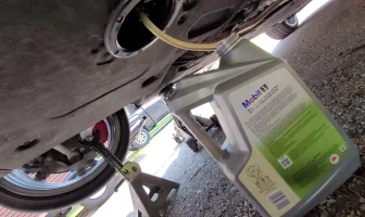

^^Wait, but the jack stand isn't touching the control arm. Looks to be 1-2" below it? So if your floor jack fails, car would drop a small distance before jackstand catches.
Wouldn't placing under the knuckle be better... Or better yet under the factory pinch weld location?
Also, no chocked rear wheels??
Btw, pretty good aim to get it to drain right into the jug :).
correct - gap between jack stand and control arm. Jack stands are only used if my jack(s) fail. ~2" gap = good enough for me.
Jack stand would hit the rim/tire - and not fully align to the area you circled
yes rear wheel are chocked - I mentioned that in post #14 from years ago
Can't put a jackstand on the pinch weld - as I am jacking from the pinch weld
Not good aim - have a ~6" clear hose between quick change valve and oil container.
Doesn't the pinch weld run the entire length? I squeeze my pinch weld adapters in like 12 inches down from the exposed part for my jack, then put the jack stands in the open spot (with puck adapters).

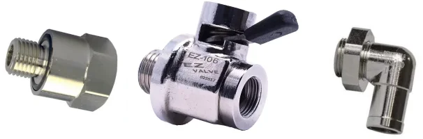

Rather than replace with a standard drain plug. Slap a quick change valve on there for tool-less oil drains going forward. Keeps my driveway more clean with no spills or splashes.
  • EZ (AL-106) Silver 14mm-1.5 Thread Size Oil Drain Valve Adapter
  • EZ (EZ-106) Silver 14mm-1.5 Thread Size Oil Drain Valve
  • EZ Oil Drain Valve (L-001) L-Shaped Hose End - 3/8" L-Shape

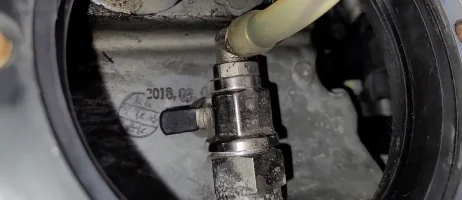

This is brilliant! I hate having a big wide catch bucket full of dirty oil and trying to pour that back into an old jug. My warranty is up in ~ half year and I'll start doing my own oil changes. If D.J. or anyone is still using this: I'm curious if that little valve holds up to the elements over the years.
I've had my Fumoto valve in for right at 2 years, and it hasn't leaked. Of course, that's only about 4 oil changes for me, but it's still very convenient.

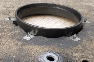

And last summer I modified underbody cover with a twist port, not as fancy as @D.J.'s but similar to the one under the filter (I think mine's technically for a 5 Series), so this winter's oil change I didn't pull either panel.
Thanks! Good to know about the underbody removable plastic cover. I'm surprised the Stinger doesn't have one stock in the plastic underbody cover. My wife's ~2015 Kia Soul had a removable piece ( ~ 4"x6") from the plastic underbody cover for oil changes.
Both my EZ change valve, and my quick access port, are working flawlessly. Not even a single unwanted drip from the valve.
Yeah I really don't understand why they included one for the oil filter (which I wish were a bit bigger, but it works ok) and not for the drain plug.
Especially considering that the latter cover is more work to remove if you don't have a lift, being further under the car. Only possibility I can think of is that it's for dealers that change oil via dipstick tube vacuum and don't touch the drain plug.
