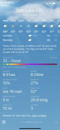

Are your only mods the snorkels and filters? If so, that's a very impressive time.
My only performance mods at the moment are the Velossa Tech Snorkels and the AEM drop in panel filters with the JB4 on the default map 2.
I ran my best 1/4 mile time a couple of days ago. It was 12.12 @116+ mph on 100% 93 Octane pump gas. No meth, no Ethanol, no Octane boosters. Stock exhaust and stock intake air box.
