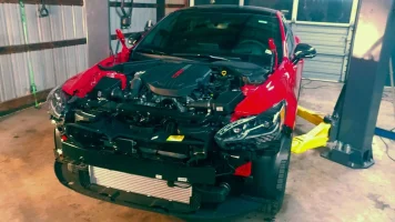

As soon as the kit arrived, I put the vehicle on the lift and started taking it apart. It sure is nice to have a garage.
I figured it would be easier to work on the car with the motor & transmission pulled, rather than working inside the engine bay.
Believe it or not, a brand new car is much easier & nicer to work on since everything is so clean.
The car has less than 500 miles, so let's see how everything looks!

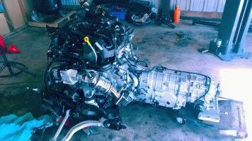

And that's how it's done! The motor & transmission are out.
You have to make sure to learn where all the wires and connections are, and it will help you a lot during the process.
