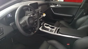

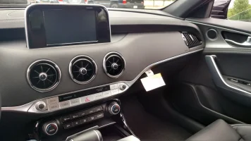

IMG_20200722_181445116_HDR.webpIMG_20200723_155230200.webpIMG_20210615_183259365.webpIMG_20210615_184917023.webp
The body of the touchscreens are different dimensions between models.
The gauge clusters are the same and bolt in — but you will need to have some of the programing changed like mileage etc. there’s a write up on here for installing the GT2 gauge cluster into a GT. Not so easy for the touchscreen unfortunately
