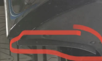

Sorry for the grave dig, I am new here. I have a 2019 Stinger GT, and I ran over some road debris and there is a hole in my fender liner. I took my Stinger in because I wanted to be sure that my alignment and balance was still good. I am likely going to replace the fender liner myself, however, I just want to make sure this “lip” portion (circled in red) is actually apart of the fender liner or if I need an additional part. Thank you for whoever comes across this post and it feels good owning a car that far too many people slept on.
That curb "feeler" is attached to the forward edge of the wheel well/fender liner.
