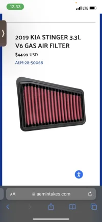

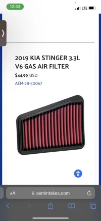

This is the second time this code has been pulled for me. First time was wot and second time when I had come back out to the car during midday after previously driving . I do have drop in Aem dry panel filters put in but that’s it . I’ve had those on for about 3k miles . Could those be the issue or positioning of them ?
That is interesting. Do you have a link to your filters? If I recall correctly, I had the issue after installing "regular" K&N intake box filters.
These are the part numbers. Might switch back to stock air boxes if it happens again since it has been reported that that was a the issue and making sure everything is snug and tight. My girl was able to briny my car into the Kia dealership today while I was at work. The check engine light cleared itself overnight . They are running diagnostics but that’s all they can do for now . They said if it happens again bring it back immediately .
Interesting, different manufacturer but they look very close to my K&N filters. My oil catch can was also full (which I think was the main issue, I hadn't emptied it in something like 4 or 5 months). After emptying the can I haven't had the issue again. I hope Kia finds something!
I hope they find something too. I’m bone stock as well so I really don’t get it. I don’t see how drop in panel filters can cause this not unless they are not tight and secure . Anyways keep you guys posted
