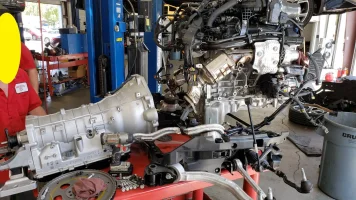

So my oil leak was due to the rear main seal leaking. REAR MAIN SEAL. Apparently when the car was built, the rubber gasket in the seal was folded over in 2 spots, and only allowed a seal for a limited time. Once that gave way ---> oil leak. If you are not familiar with this part, neither was I, but I soon learned that the only way to fix it is to remove the engine, transmission and associated goodness. My car was out of commission for about 1.5 weeks to replace the seal.

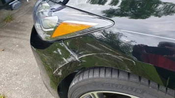

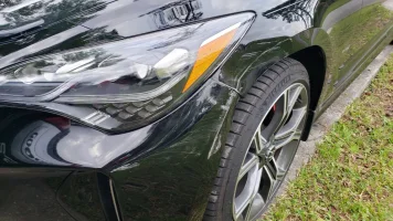

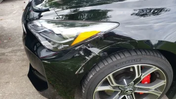

Keep in mind, at this point the car has 3600 miles on it. So when the work was complete I picked the car up, it was a Friday... Between that Friday and Saturday I put about 500 miles on it. Saturday night we go to an Arena Football game in Jacksonville. Driving home I noticed the car was making a strange noise, especially when turning. Get home about 30 miles and I look at the car in my driveway and I see this (pictures taken next morning):
Now I usually don't park near other people and this night I didn't as well. Someone had decided to hit me, while I was parked, by myself, during the game, and didn't even leave me a sticky note. Insurance covered the damage (minus my deductible because I didn't have a police report) and the car was out of commission for about another month waiting on parts and the actual repair and painting.

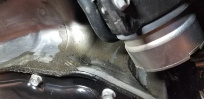

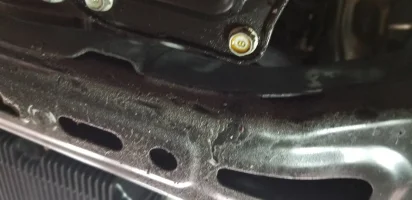

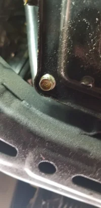

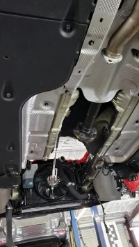

I have had an oil leak since the first oil change at 3K miles. The dealere had the car for 1.5 wks and said they replaced the upper and lower pan gaskets after consulting with Kia. That was in early 2019. I have been back to the dealer for the second oil change and they said nothing so i figured I was all good. Now at 15k miles I dropped the under body panel to do my own oil change and what do I see? Oil on the lower pan and the area above the pan, the subframe cross member, also on the underbody panel. So I pull the dipstick and the oil looks to be a half to a quart OVERFILLED! I am concerned there is water in the oil. The radiator shows full but the overflow tank is empty and has been slowly losing level since the car was new. I am taking it in to the dealer Monday as I called the service manager as soon as I discovered the leaks again. He knew who I was as I am the only Stinger owner with any oil leaks.
I am wondering if I should drain some of the oil before taking it in to see if there is water in it? or trust the dealer to eval the problem correctly and come clean with me.
Pics to support above20200402_125058.webp 20200402_125130.webp 20200402_125335.webp
There are no drips on the ground as they are caught by the underbody panel and that shows evidence of the leaks on it. So is an 'ooze' considered acceptable on this car? I am of the opinion that any fluid leaks on cars, especially new ones, are not acceptable. I am concerned about coolant in the oil because the oil level is fully over the top of the plastic dipstick gauge by 1/4 of an inch and the radiator overflow tank is empty. I am trying to figure out why, in the presence of a leak, the oil dipstick would show an overfull condition.
There's nothing normal about your car leaking oil. And water in the oil is an even more serious cause for concern. Ignore any moron that tells you different. If you have a different dealership/service department in your area take your car there instead of the one you've been using.
No, "ooze" is not acceptable. But it isn't a worry, vis-à-vis your car is going to fail. I asked about why you feel there is water in your oil. I'm trying to learn something. Simply overfilling the oil could show above the line for a long time with an ooze/drip. And we've read on here numerous times the question about seeing our cars with oil over the top line. Mine has it every time I get an oil change. And maybe I have an "ooze" issues too and just don't know it.:P I go by what I see on the carport floor.
