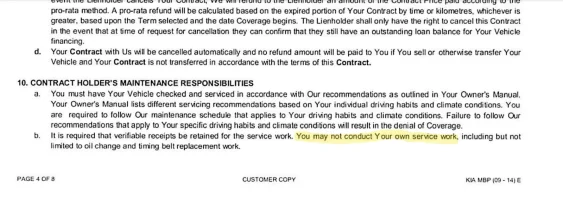

I don't think you want to hear this, but sharing it anyway.
If you have the Canadian Kia 5 Star warranty (MECHANICAL BREAKDOWN PROTECTION, MBP) and purchased it with your car when new, like I did, you are explicitly not permitted to change your own oil or perform your own maintenance (page 4 of 8 in the MBP document, section 10, CONTRACT HOLDER'S MAINTENANCE RESPONSIBILITIES), while maintaining the extended warranty. They documented this in the fine print very clearly, unfortunately.
I do my own oil changes as well, and I hope I I'm never in your position.
I have used my extended warranty successfully for approximately $8,500 worth of repairs, but none were engine related.
Yes i've just read my contract. It is written that we cant do our own service work on the car unfortunately. I will see what there are going to say
