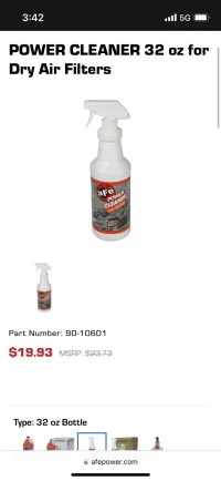

Kind of quality I like. Can’t wait for mines to get here. Did you get the pro 5r or pro dry S ? I got the pro dry s. Also for cleansing the filters would you simply just spray this solution and call it a day every so often
