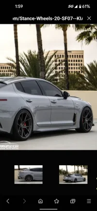

this is a 285 on a 10.5 not my car but I'm done a lot of research on this so I know what I want to buy, rear is a 45 offset front is a 23
is this your car ? what are the exact offsets and sizes you are running ?
Off set is +45ET rear 20+10 1/2
Tire is 285/30 Front is +23ET 20+9 245/35
lowered on springs
