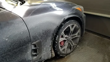

For comparison, here's how mine looks like just after a few KMs on our wet salty roads.View attachment 2140

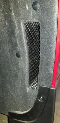

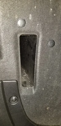

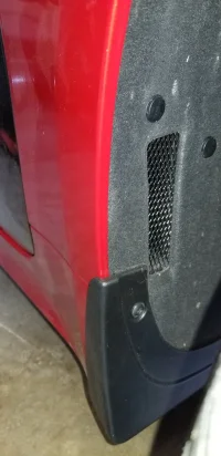

Nice job, I like the vent mesh screen install, very clever, is anyone marketing/selling these?I installed my splash guards yesterday. It took about 20 minutes to install...5 minutes each. Very simple to do. I saw someone put a screen on the brake vent in the wheel well (another post on this site). The person that posted said rocks went through and chipped the rear door paint. So, Menards had this black screen in near the grill accessories for $3. The screen is anchored by the two black pins. The screen extends about 1/4" all the way around except for the parts that extend to the plastic pins. They took about 20 minutes to install.

Looks good in there, and I like that it will still pass a lot of heat/air vs. the perforated panels I saw in the other post. Is the material plastic or metal - what was the 'intended' application for that screen?So, Menards had this black screen in near the grill accessories for $3
kidney stones ....... no seriously !Looks good in there, and I like that it will still pass a lot of heat/air vs. the perforated panels I saw in the other post. Is the material plastic or metal - what was the 'intended' application for that screen?
Did the mesh sit in the vent hole or over it? Because if it’s over it the lining won’t seal the water out from getting in behind the lining and causing rust. My ones sit in hole don’t need fixing as the lining holds it in place.I installed my splash guards yesterday. It took about 20 minutes to install...5 minutes each. Very simple to do. I saw someone put a screen on the brake vent in the wheel well (another post on this site). The person that posted said rocks went through and chipped the rear door paint. So, Menards had this black screen in near the grill accessories for $3. The screen is anchored by the two black pins. The screen extends about 1/4" all the way around except for the parts that extend to the plastic pins. They took about 20 minutes to install.
Use stainless steel mesh, no rust issue then.Did the mesh sit in the vent hole or over it? Because if it’s over it the lining won’t seal the water out from getting in behind the lining and causing rust. My ones sit in hole don’t need fixing as the lining holds it in place.

Behind the lining, the water will sit in the fender door area not the mesh.Use stainless steel mesh, no rust issue then.
Oh gotcha.Behind the lining, the water will sit in the fender door area not the mesh.
