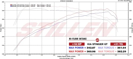

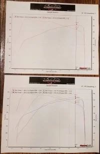

The top two images are the manufacturer dyno charts for Stillen and K&N. The bottom one is a KIA Stinger owner that had their K&N dynoed before and after intake installation. I have not seen a independent Stillen dyno but it makes you question the legitimacy of any manufacturers claim. I'd link to the independent K&N source but it is on a different Stinger forum... you can google "Dyno results : Stock vs K&N Typhoon on 3.3TT"

There appears to be quite a difference in the low end

However the torque curve on the last dyno must be completely incorrect. There’s no way any intake would lose over 100TQ@3k RPM...:confused: Even down 50TQ@3500 is way off. I cant imagine losing more torque at low RPM than HP gained at the top end. I think losing 10TQ initially may be reasonable if gaining 12HP throughout the power curve is accurate.
I find it surprising but without another data point I wouldn't say that it's incorrect. I honestly would trust that any shop that has a dyno would know how to install a CAI and use that dyno for comparison purposes.

Yeah but this shop obviously doesn’t know what they’re doing, or they are specifically trying to inflate bad numbers.:cautious: Why didn’t they include other data points or multiple dyno runs for comparison. Most dynos have trouble accurately measuring low end torque so a reputable tuner would have done multiple runs for verification of the initial test. That’s another reason why good tuners do at least 3 runs for testing. IMO the odds are much higher that they simply had 1 inaccurate run over losing 100TQ from intakes.:thumbup:
