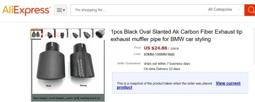

@Yusha heres a snapshot of the order - looks like that item is no longer active but it also didn't show the AK logo which I actually prefer without, order took 27 days from Shenzhen through HK my old stomping ground and then onto the US/Canada by DHL.
Props to Jaymorz for his black tips they looks great also!

Hey recently joined the club (cheers @Gtecko ) with the mbrp amd went with the oval tips from aliexpress 63MM-105MM Matt
They look great and don't sound too raspy thankfully..stock downpipe etc. So I'm happy there.
I'm still getting used to 'auto' transmission low rpm (1-2.5k) exhaust noise kinda reminds me of stupid exhausts on crappy cars. I do really enjoy the mbrp went getting on it and it has a great character and glad it's not over the top. I think the downpipe is the issue as others have said it def more aggressive in other cars I've done. This is the first performance car without a manual so I think I just have to get over it lol
One think of the tips is internal vs external diameter as the shop doing the install had to fab something up and weld them on as the diameter were the same as the exhaust..I'll take a pic in the morning. Helps i think with drone not rasp and I like the black look, makes the rear diffuser look sexy!
Do you have a link for those tips? Matte black, correct? Having a difficult time finding anything but chrome or carbon fiber. Was going to order chrome and have them powdercoated if I couldn't find them in black.
