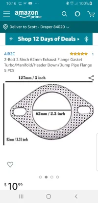

Will these fit my mbrp exhaust flanges, I'm about to order them but just want just want to make sure they're correct or at least close to it.
You don’t need them. Reuse the stock ones.
Well my car only has about 8,500 miles so I was hoping that would be the case but for whatever reason they fall apart when removed my guy installing is not an exhaust shop that's my only concern.
i installed mine myself. reused the stock gaskets and they were fine at 16000 miles or so. I'm sure yours will be good to go
I forgot to mention this also includes downpipes. I know those ones tend to get a little more crispy coming off today primary cats into secondary cats extreme heat.. anybody reuse to those before?
I had my gaskets removed from the stock downpipes this week and reused them on my new ones without a problem...gaskets were still in good condition after 25K miles.
