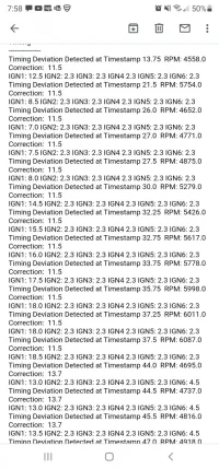

And quote"The turbo sounds like this because the boost is high at that rpm.
According to log and will H mapbot its decently pulling timing and creating alot of knocklooks like it's either pulling timing or fluctuating throttle. I have something similar but it's not as pronounced. it's only in a higher gear with a gradual pull. with wot it's not there. I this wot?
thats not good. is it boost related?According to log and will H mapbot its decently pulling timing and creating alot of knock
I'm running E30How much timing is being pulled and what octane are you running?
Do you think it could be the gap on the hksMy tune also sounds like this but only when boosted at highway speeds. I have only pushed this tune hard a few times recently since I have changed my plugs. I have now reinstalled stock ecu waiting for Lozic reply.
I wouldn’t think so. If they were on while you were running the JB4, the only variable is the modified ECU.Do you think it could be the gap on the hks
I'm also running them
I wonder if there changes in atmosphere or air temp from one side of the planet to the other that need to be taken in to account for timing.
....or just general inconsistencies from one car to the next. I’m not sure how many “canned” tunes Lozic has over in North America or even Korea. But, it appears the canned tune isn’t good enough for our fuel based on the limited reports so far.
Darn it!
Well I tried more e85 than usual to see if it was fuelThat and fuel.
