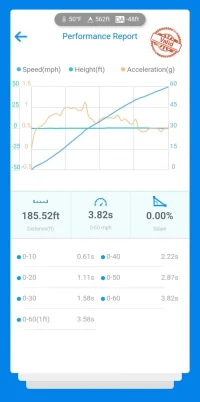

So I tried launching in sport mode with only TC off and SC on. The RPM did hold at 2.3K RPM and I built approx 6psi of boost before I let off of the brake. The result was a 3.82 0-60mph and 7.67 1/8 mile. I would describe the launch as sluggish. Launching this way probably puts less strain on the drivetrain but will not produce the fastest times. You can see from the graph that there is no initial burst of acceleration. Instead it's gradual. It appears that 60ft is also going to suffer when launching this way. My guess is the torque limits is holding the car back when launching this way.

Appreciate the detail! Thanks for that. So basically a slower safer way to launch- but still on boost for better than factory etc. This thread an community is fantastic. Appreciate you all helping a newer stinger owners curiosity. I’ll practice the torque off launch and see what I can do. I’m sure with practice I can be more consistent. End of March I’ll be ordering the ECU as well.
